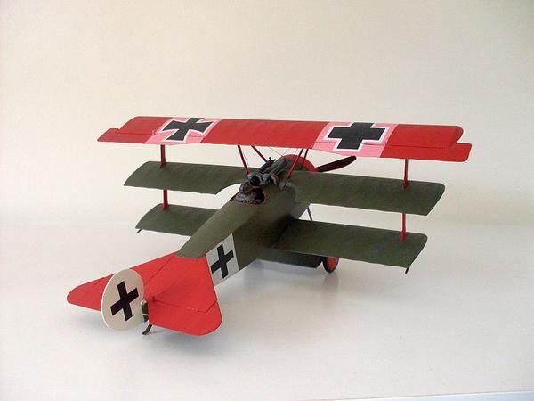

For anyone with very limited or no WW1 aircraft modelling experience I would recommend the 1:32 scale Roden Fokker Dr.1. This is a relatively easy kit to build and with only very minimal rigging it makes the first step into WW1 aircraft a pain free exercise. Naturally, any amount of detail can be added to this model but even straight out of the box (OOB) it builds up to be a very nice and well detailed model.

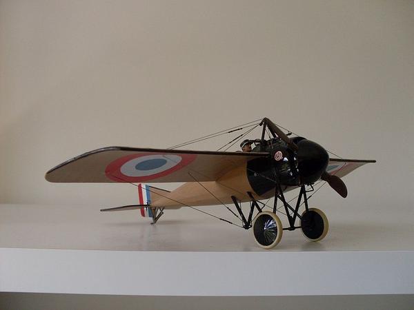

The 1:32 scale Morane Saulnier type N by Special Hobby is again another kit that builds up fairly easily. It has more rigging than the Fokker but not being a Bi-plane it makes the rigging process a lot easier, you will learn valuable rigging experience with this kit without the hassle of having to work between the two wings. This kit is well detailed but any amount of extra detail can be added, it builds up to be a lovely model.

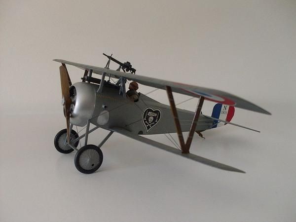

The Academy 1:32 scale Nieuport 17 is a beautiful aeroplane and this kit is a real pleasure to build. It has limited rigging which is easily installed with just a little bit of rigging experience. Construction is straight forward and a lot of knowledge will be gained during the build and again, if you so desire, you can add more detail. OOB it is a great model.

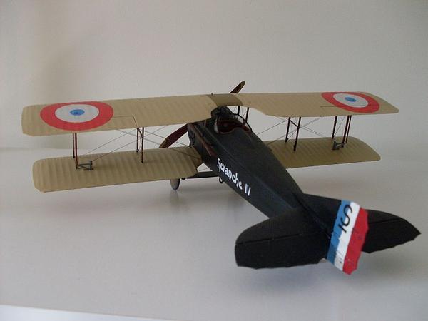

Rigging is difficult enough for the inexperienced let alone double rigging. These three models all have double flying wires which if not done properly will detract from the overall look of the finished aircraft. They are lovely kits to build and make to be a fantastic looking model but a fair amount of modelling skills will be necessary to achieve the desired look. The Spad, having 4 sets of struts, means double the amount of rigging and with only a small distance between the upper and lower wing makes this a difficult aircraft to rig. The Sopwith Pup, an absolutely beautiful model, has double flying wires so again, the rigging task is made just that little bit more difficult. The SE.5a by Roden is a great kit, built OOB makes up to be a good looking model, but there is plenty of scope to add your own details or after market PE sets. This plane also has double flying wires so moderate to average modelling skills would be required to accomplish a respectable result. You must also remember that nearly all the models listed have rigging on the undercarriage and tailplane, plus there is the control rigging, elevator, rudder and ailerons.

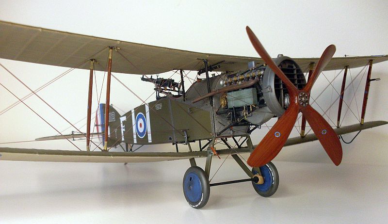

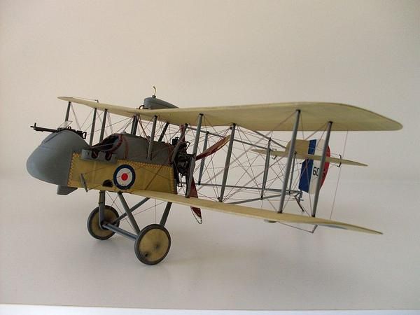

The WNW Bristol F. 2b, like the other WNW kits is brilliant. Rigging is quite complicated and requires plenty of previous rigging experience, there is a lot of it. The control cable rigging is also a challenge, it too is double cables but this time with turnbuckles, see here. This is another user friendly kit. Full build log can be found here.
This is the Roden DH-2, the feature photo on my home page. This is definitely not a kit for the beginner, it has a few inbuilt flaws which require pretty good modelling skills to rectify, it is lacking certain details which can be manufactured but you need some experience to achieve that, but most importantly, the rigging. The rigging is extremely complicated and it is essential that you have a rigging diagram to follow.
The wing struts and the tail booms are very flimsy so require very careful handling when performing the rigging operation. It does build up to be a beautiful looking model and would compliment any WW1 aircraft display cabinet, but leave this one until last, gain as much experience as possible then when you feel confident enough you can tackle this one.

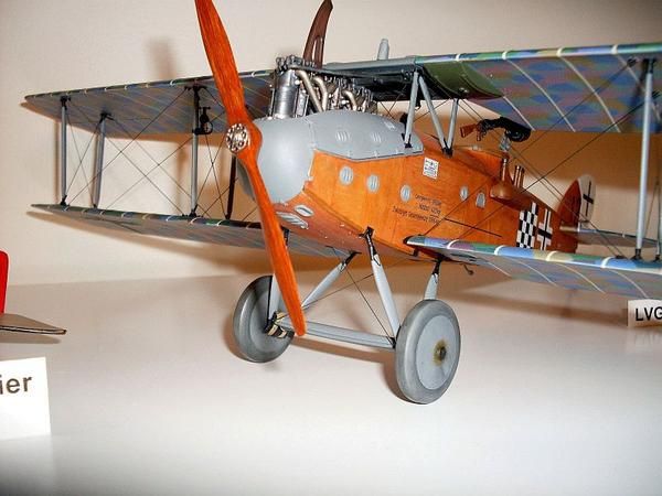

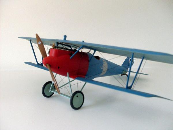

Below are some photos of the completed models listed above. I prefer to build my models OOB (out of the box) and only add small amounts of detail from materials I have on hand. For those wishing to add PE (photo etched) sets there are plenty available as after market accessories. A lot more kits are now being released with PE included with the kit, I think this will be a trend that will see complete PE sets with every kit soon. Modellers are demanding top quality, highly detailed and more sophisticated kits these days so the manufacturers are producing these kits to suit the modellers wants and needs.

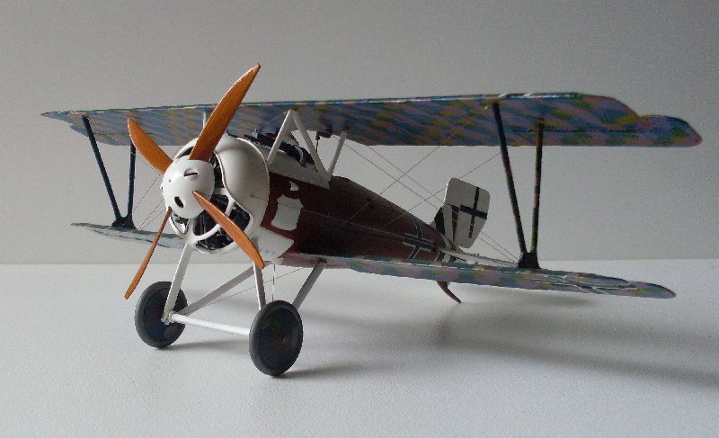

Albatros D.III
Morane Saulnier
Fokker Dr.I

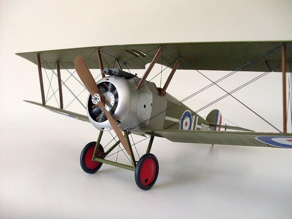

Sopwith Camel

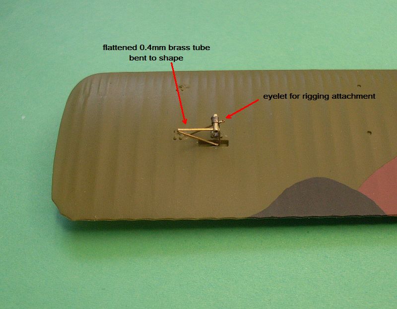

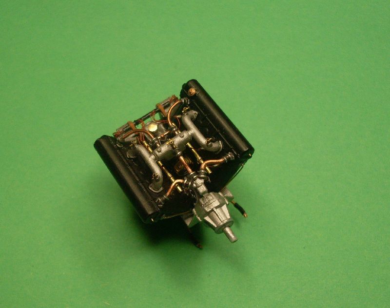

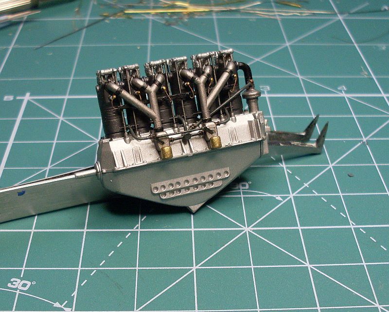

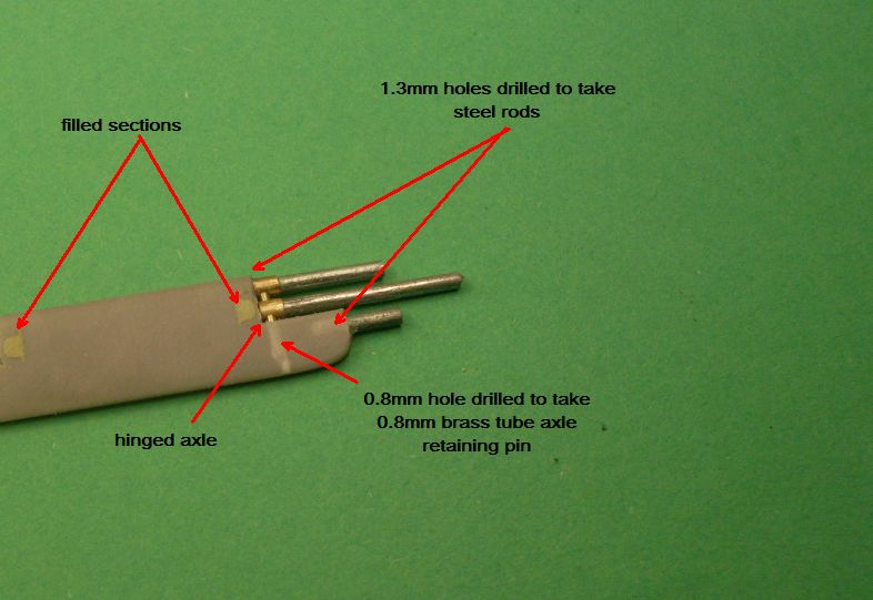

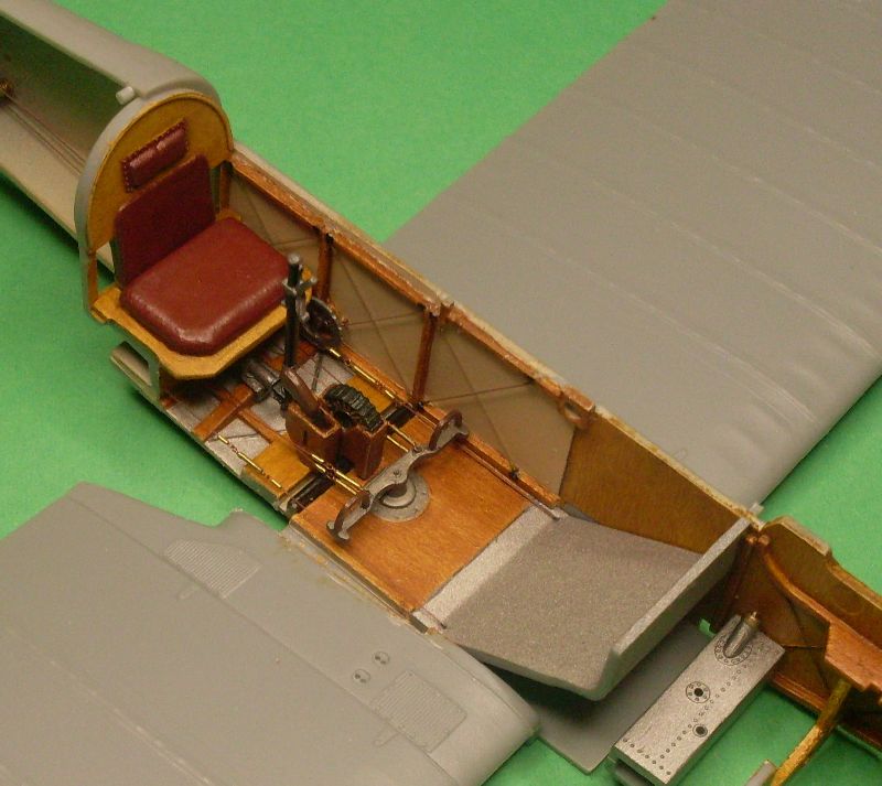

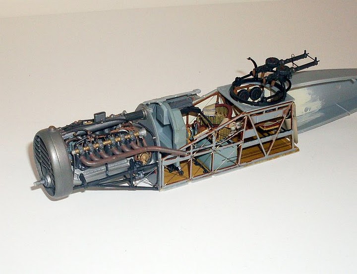

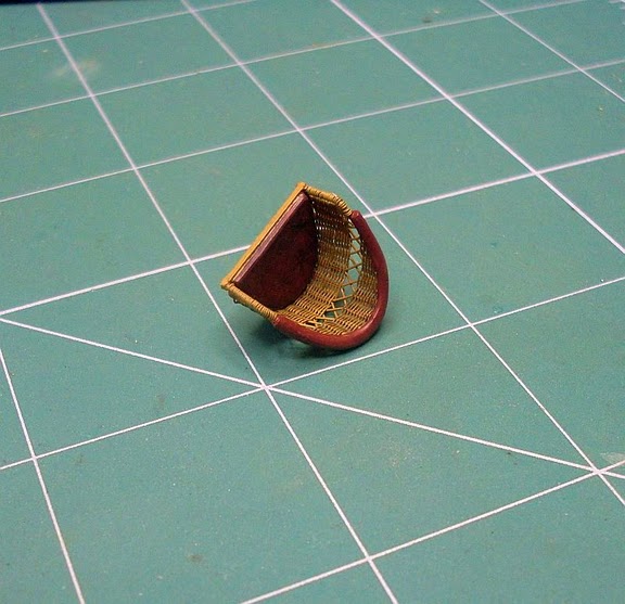

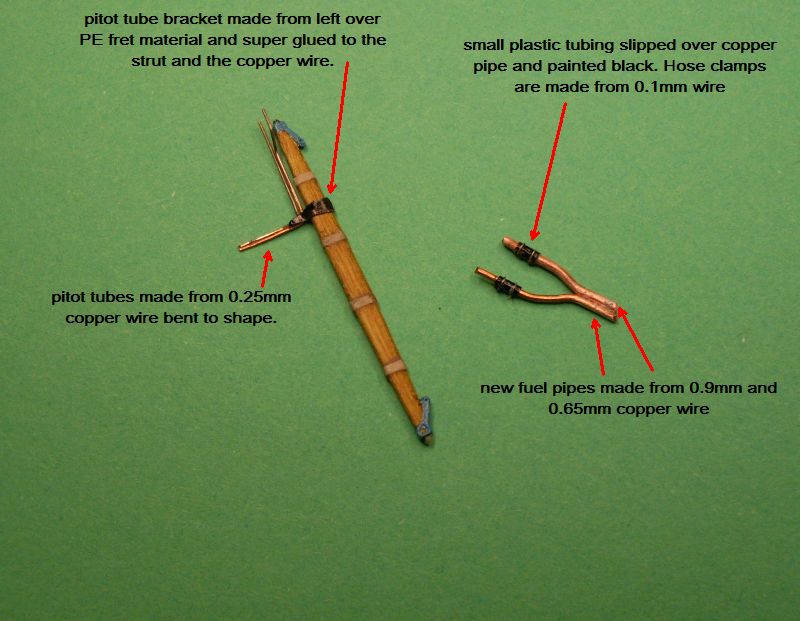

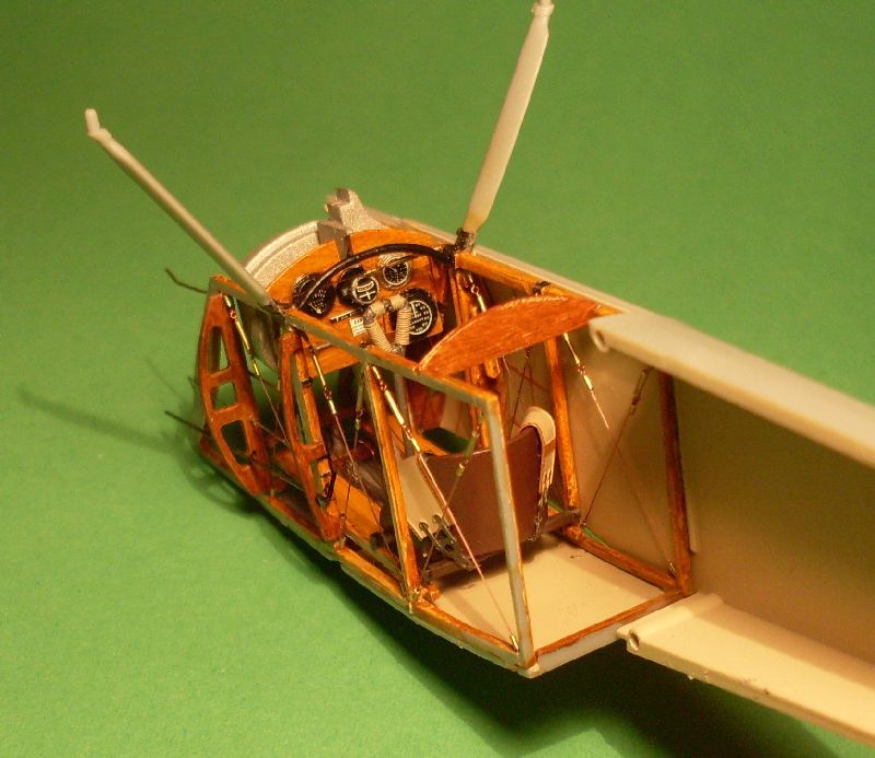

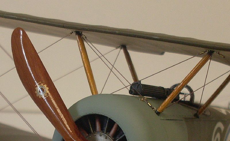

Here is just a small selection of photos of what can be done to enhance the kits with some simple added detail. I prefer to make all my own detailed parts instead of buying after market accessories, most of what you see here are made from scrap bits and pieces. I like using brass tube which is available in a variety of sizes and is inexpensive, it can be used for a multitude of applications from inside the cockpit, engine detailing and undercarriage. My main use of the brass tube is for making rigging turnbuckles. Collect as much copper wire as you can and store for later use. Any type of multi strand electrical cable, once stripped, will reveal large amounts of fine copper wire which can be used for just about anything, the range of wire sizes is nearly endless.
Starting with a basic WW1 aircraft kit try adding just small amounts of detail, don’t go overboard with your first attempt. You will find that even the smallest added detail will change the appearance of your model. As you gain more experience and learn how to manufacture small detailed parts, each model will become more and more detail. Cross referencing with books, net downloads, photos and any other material you can find will allow you to make just about anything which was on the real aeroplane but lacking with the kits. You will be surprised how such a small hand made item will alter the look of the model, making it look more realistic and adding a great talking point when viewed by admirers.
